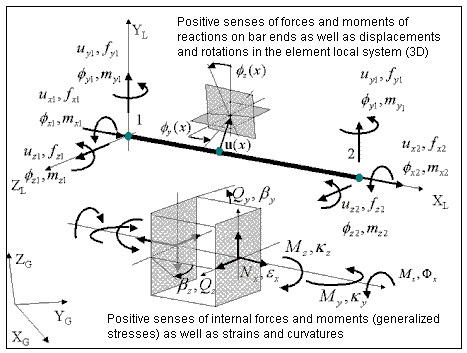

    Geometry, sign convention for forces, displacements, stresses and strains
    Basic kinematic relationships

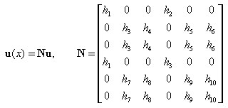

    Displacement approximation
    When there is a possibility to consider shear influence and consistence of results obtained for the linear element, physical shape functions considering shear influence have been implemented.
    2D bars:
    Shape functions and their derivatives are expressed by the formulas:
    where:
    x = x / L
    for planes XY and XZ, respectively.

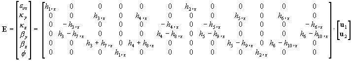

    Kinematic relationships for the matrix notation (the geometrically linear theory)
    When considering the influence of imposed strains
    Increment of generalized (sectional) strains:
    2D:
    3D:
    where:
    Strains at a point (layer)

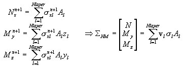

    On the cross-section level, the vector of internal forces (stress resultants) is composed of:
    States of shear and torsion ΣST are treated as linearly elastic and not conjugated with the state of axial/bending forces on the cross section level.
    Compression/tension states Σ NM are generally treated as conjugate when applying the layered approach. However, as long as the elastic state is guaranteed, i.e. until the current generalized strains fulfil the following elastic state condition:
    where:
    the cross section is treated as elastic and the layered approach is not activated.
    Once violation of the elastic state condition is asserted, stresses induced by axial strains and bending are calculated separately for each layer and on their basis sectional quantities are calculated

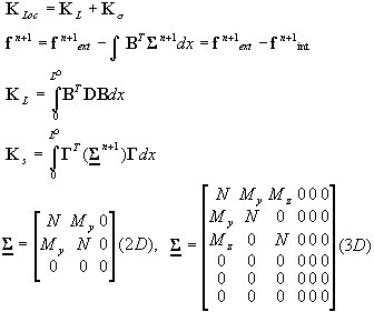

    Nodal force vector and element stiffness matrix
    Algorithm on the element level
    The element geometry is not modified; the local-global transformation is performed with the use of initial transformation matrix 0 T
