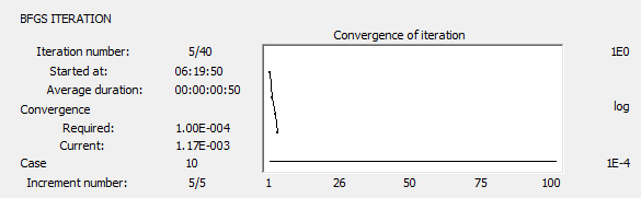

The tolerance (required convergence) of the eigenproblem solution is determined by the formula:
The tolerance parameter (tol) is defined in the Modal Analysis Parameters dialog. The accuracy of calculations can be increased by reducing the tolerance tol value. This results in the growth of the number of iterations.
Additionally, the following information is given:
