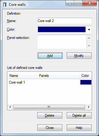

After selecting this option the following dialog displays.
You can specify the following parameters in the above dialog:
In order to define which panels will build the defined core wall, follow the instructions:
- graphically, indicating the selected panels on the screen
- textually, entering the panel number in the edit field
The defined core wall will be added to the list of defined core walls which is located in the bottom part of the dialog.
The defined core wall may be modified. After changing some of the core wall parameters (e.g. name of the core wall) and pressing the Modify button, the core wall parameters are modified in the list of modified core walls.
At the bottom of the dialog box there are the following buttons:
