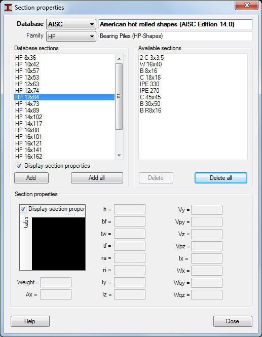

Selection of a bar section from an available section database
The following dialog adds or deletes bar sections from a selected section database to or from the list of available sections.
At the top of the dialog there are two selection fields.
The central part of the dialog contains the following tools.
To add sections to the list of available sections, follow the steps below.
  1. Select a section database in the Database field.
  2. Select a section type.
  3. Select a section (or several sections) in the left panel.
  4. Click >.
Click >> to add all sections located in the left panel to the right panel.
Click < to delete a selected section from the list of available sections.
Click << to delete all the sections on the list of available sections in the right panel with the exception of sections which have already been used in a project.
Click More >> to expand the dialog and view more properties of a section. These properties include cross-section dimensions, area, moments of inertia, section modulus for calculation of torsion stresses, shear area - reduced extreme shear stress coefficients and weight. Click Less << to collapse this additional information.
