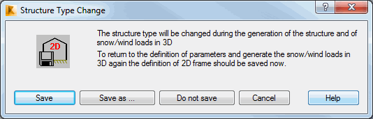

Structure Type Change
The following dialog displays, when you have generated a snow/wind load in 2D, but before running the simplified snow/wind load generation in 3D.
The dialog has the following buttons:
When you click Save or Save as, you can:
Note: Robot requires a project to be saved when a structure type has changed. Therefore, if a 2D frame has not been given a name yet, Robot opens the Save as dialog. A 3D structure is saved without the 3D loads.
