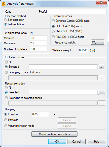

Footfall Analysis Parameters
Use the Footfall Analysis Parameters dialog to specify parameters for the analysis of dynamic excitation caused by foot falls from moving individuals or groups, for a load case defined for a structure.
To open the dialog:
  1. click the New button in the Analysis Type dialog
  2. select the Footfall option and click OK in the New Case Definition dialog.
You can specify the following parameters in the dialog:
Frequency weight (Wg or Wb), used to calculate weighted acceleration values for excitation forces according to SCI P354
Click the Modal analysis parameters button at the bottom of the dialog, to open a dialog to define a value of the frequency limit and active mass directions.
