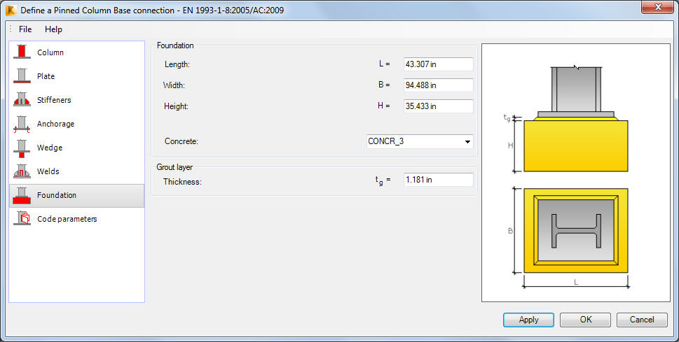

Foundation
Note: The tab is available for Autodesk Robot Structural Analysis 2015. It is not available for Autodesk Revit Structure 2015.
Use the Foundation tab to define basic parameters of the foundation; you can also select a concrete class for the foundation. This information is used to calculate the resistance of the column base plate for bearing pressure onto concrete. In the Grout layer field you can define parameters of a grout layer that is usually placed to correctly position the column and to ensure that the base plate is in complete contact with the foundation.
