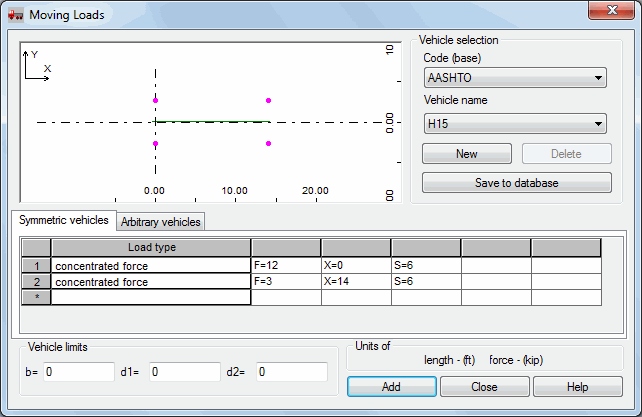

After clicking New Vehicle icon in the Moving loads dialog, the following displays.
A vehicle is a set of forces that constitutes the load in a moving load case. The vehicle moves along a defined route by a distance referred to as a step in the route of a moving load case. Each individual position of the vehicle is saved in the successive case component.
A vehicle definition can include concentrated, linear forces or planar forces acting on a linear contour.
The dialog lets you select a vehicle to add to the active list of vehicles in the Moving Loads dialog. There are 2 vehicle types available:
The dialog has several parts. The upper right corner of the dialog has the Vehicle selection field, where there are 2 selection fields: Code (database) and Vehicle name. In addition, there are 3 buttons:
The upper left corner displays a diagram of the selected vehicle.
The middle of the dialog has a table displaying a description of the loads for the selected vehicle. Robot provides 3 types of loads: concentrated load, linear load, and planar load. You can change the load parameters that are defined for a vehicle.
The following parameters must be defined for individual load types (dimensions are displayed diagrammatically in the following images for load types):

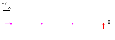

Concentrated force ![]() |
Symmetric vehicles: F- value of a concentrated force (unit: force) X - Coordinate value of the point where the force is applied (along the vehicle axis) S - Width of the force spacing Asymmetric vehicles: FX, FY, FZ - values of a concentrated force X - Coordinate value of the point where the force is applied (along the vehicle axis) Y- Coordinate value of the point where the force is applied (perpendicularly to the vehicle axis) |
Linear load ![]() ![]() |
Symmetric vehicles: Q - Value of a linear load (unit: force/length) X - Coordinate value of the line along which the force is applied (along a vehicle axis) S - Width of the linear load spacing (only in the Y axis direction) Dx - Length of a segment along which a load is acting (along a vehicle axis) Dy - Length of a segment along which a load is acting (perpendicularly to the vehicle axis) Asymmetric vehicles: Compared to symmetric vehicles, instead of the S value there is Y - coordinate value of the point where the force is applied (perpendicularly to the vehicle axis) |
Planar load ![]() |
Symmetric vehicles: P- Value of a planar load (unit: force/length^2) X - Coordinate value of the line along which the force is applied (along the vehicle axis) S - Width of the planar load spacing (only in the Y axis direction) Dx - Length of a rectangle side upon which a load is acting (along the vehicle axis) Dy - Length of a rectangle side upon which a load is acting (perpendicularly with respect to the vehicle axis) Asymmetric vehicles: Compared to symmetric vehicles, instead of the S value there is Y - Coordinate value of the point where the force is applied (perpendicularly to the vehicle axis) |
The lower part of the dialog has 2 fields:
b - Vehicle width
d1 - Distance between the load and the vehicle contour (from the vehicle front)
d2 - Distance between the load and the vehicle contour (from the vehicle back)
forces - The units in which the values of forces are displayed (the units can be modified in the Job Preferences dialog)
length - The units in which the values of length are displayed (the units can be modified in the Job Preferences dialog)
