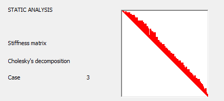

This dialog presents individual phases of calculations:
The frontal method solves the K * x = b linear equation system. The stiffness matrix K is decomposed (frontal decomposition) into the two matrices K = L * U (Gauss elimination procedure). This method is based on the element-by-element aggregation of the matrix
, where Nele denotes the number of finite elements and Ke is the relevant element matrix.
