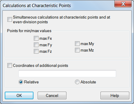

Use this dialog to define coordinates of the characteristic points, for which member calculations or verifications will be performed.
Access
- In the Steel/Aluminium design layout, click Configuration in the Calculations dialog.
- In the Configuration dialog, click Options.
Note: The SP16.13330.2011 code replaces the former SNiP II-23-81 version of the code for steel structures. Therefore, all references to tables or sections of the code apply to the SP16.13330.2011 code except otherwise stated.
Dialog elements
- Simultaneous calculations at characteristic points and at the even-division points
- Performs structure member calculations for both the defined characteristic points, and the number of calculations points.
Note: The number of calculation points can be defined in the Number of points option of the Configuration dialog.
- Points for min/max values
- Select the points in which the internal forces reach their maximal values.
Note: Internal forces include: longitudinal force Fx, transversal forces Fy and Fz and bending moments My and Mz.
- Coordinates of additional points
- Enter the coordinates of the additional points, and then specify if these coordinates are relative or absolute.
