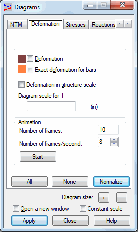

Deformation
When the Deformation tab is selected on the Diagrams for Bars dialog, the following displays:
You can select how to display structure deformation because of loads in this dialog.
To do it, use one of the following options:
For the quantities listed, you can select the appropriate color and scale.
You can also display displacements from static structure analysis as well as eigen vibration modes from dynamic structure analysis.
You can find the options for animating structure deformation diagrams on this tab. You need to provide 2 parameters to activate the animation: the number of frames created and the number of frames per second. After clicking Start, Robot begins the animation based on the assigned parameters. During the animation, a toolbar displays with options to stop, pause, replay, and so on.
You can save the structure deformation animation to an *.avi file. You can also read and replay the *.avi file in which the structure deformation animation was initially created.
