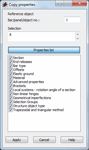

When you select Copy Properties from the menu, a dialog displays:
Clicking Apply button copies the selected parameters of the reference object to the selected objects.
