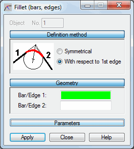

The dialog has 4 parts:
- Object field, where you specify the number or identifier of the created/selected object
- Definition method
- Geometry
- Parameters.
When the Fillet dialog is maximized, clicking 1 of the 3 buttons (Definition method, Geometry,or Parameters) minimizes the relevant part of the dialog to form a button. Therefore, the dialog can display exclusively the options needed by you at a given moment. When the dialog is minimized, clicking 1 of the 3 buttons to maximizes.
Definition method
Definition method lets you select a fillet (arc) definition method. The method is selected by clicking 1 of the following buttons:
- Symmetrical - When selected, the fillet is created as a section of a circle that is tangent to both edges in the selected edge ends.
- With respect to edge 1 - When selected, the fillet is tangent to edge 1 in the selected node, and the geometry of the fillet determines its meeting-point with edge 2.
Geometry
If Symmetrical is selected, you must define the following 3 parameters:
- Radius - Specifies the radius of the fillet.
- Bar/edge 1 - Specifies the number of the first bar/edge whose position defines the fillet.
- Bar/edge 2 - Specifies the number of the second bar/edge whose position defines the fillet.
If With respect to edge 1 is selected, you must define the following 2 parameters: Bar/edge 1 and Bar/edge 2.

You can define a fillet in the following way:
- Select the method for defining a fillet (symmetrical or with respect to edge 1).
- Define the bars/objects between which the arc (fillet) will be created:
- textual definition: Enter the bar/object numbers in the dialog and the radius value (for the Symmetrical method).
- graphical definition: Click in the Bar/edge 1 field and select the first bar/edge in the drawing area, and repeat the procedure to define bar/edge 2 and the radius (in the case of Symmetrical method).
- mixed method that combines graphical with textual definitions
- Click Apply to execute the operation after defining the parameters for a fillet (number of divisions, bar adjustment, and create bars).
