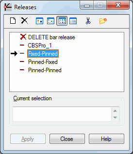

The Releases dialog defines structure releases. It has the following:
- Active list field - List of the selected or defined types of releases that can be assigned to a structure's bars or nodes. That field also has information about the label and the release type
- Current selection field - Displays the current selection of the structure nodes or bar. You can define a release in a structure's nodes or bars.
- Standard buttons (Apply, Close, and Help).

When a full list is selected, the parameters of the defined releases are displayed:
- If x displays in the second column, this release type has already been used in the structure.
- Codes describing the definition of a release display in the third column (x indicates the fixed degrees of freedom and f indicates a released degree of freedom).
