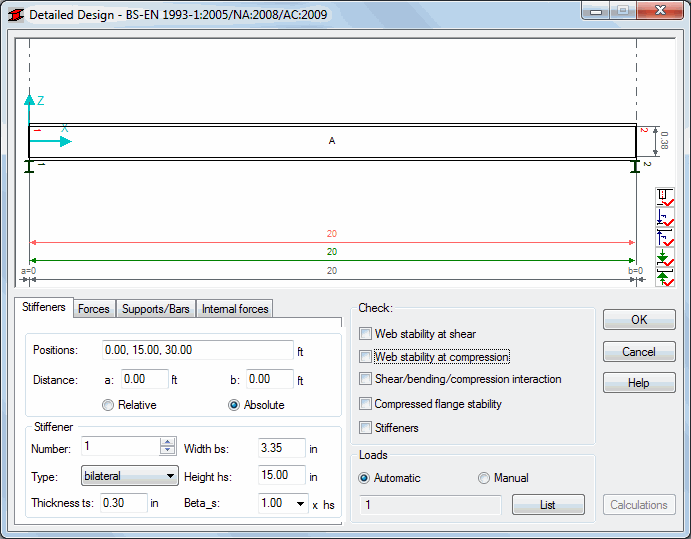

Use this option to perform detailed analysis of I-section members, rolled or welded. Access the option by clicking the Detailed button in the detailed results dialog for the EC3 code.
The following types of analysis are performed indepandently and run separately, based on the requirements defined in EUROCODE 3:
The dialog is divided into several parts.
Turns on/off the presentation of ribs, rib numbers, panel numbering and distances between ribs |
Turns on/off the presentation of the forces operating in the top flange of the member, their numbering and the distance between the forces |
Turns on/off the presentation of the forces operating in the bottom flange of the member, their numbering and the distance between the forces |
Turns on/off of the presentation of supports/adjoining bars located in the top flange of the member, their numbering and the distance between supports/adjoining bars |
Turns on/off the presentation of supports/adjoining bars located in the bottom flange of the member, their numbering and the distance between supports/adjoining bars |
