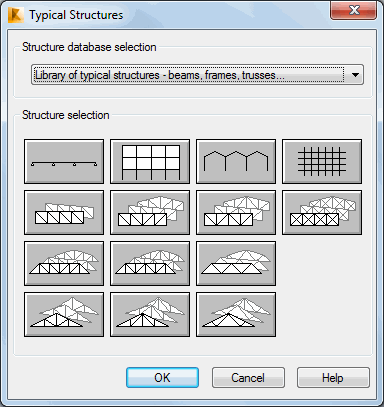

This option lets you select or define typical structures (structure elements). This option is available in the Design 3D module, using either method:
Library structures are organized in certain databases. To select a structure, first you must find an appropriate database. The following databases are available:
The dialog shown above has several buttons with icons symbolizing the appropriate types of bar structures. Several typical bar structures are available, such as:
