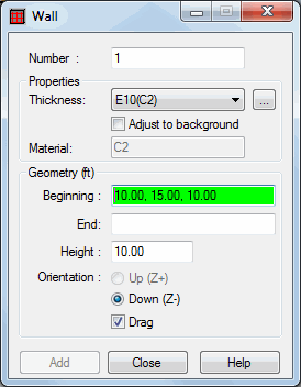

Open the Wall dialog using either of the following methods:
- Click Geometry menu > Walls.
- Click
Use this option to define walls in a structure by specifying the following:
- Coordinates of the start and end points of the wall base line
- Wall height
- Orientation along the assumed vertical axis Z ( up, down).
You define a wall by specifying:
- Wall number
- Wall properties:
- Thickness; Adjust to background - when selected, while a wall is being drawn, its thickness adjusts automatically to lines of the wall contour
- Material (this field is not available for editing; it displays the material defined for a selected wall thickness type)
- Wall geometry:
- Beginning and end of a wall
- Wall height
- Orientation (up or down with respect to the position of the beginning node).
In addition, the default material is displayed for the selected wall thickness type.
Note: You can define a new panel thickness types by clicking
next to the Thickness field.
When Drag is selected, the end of the wall being defined is also the beginning of the next wall.
