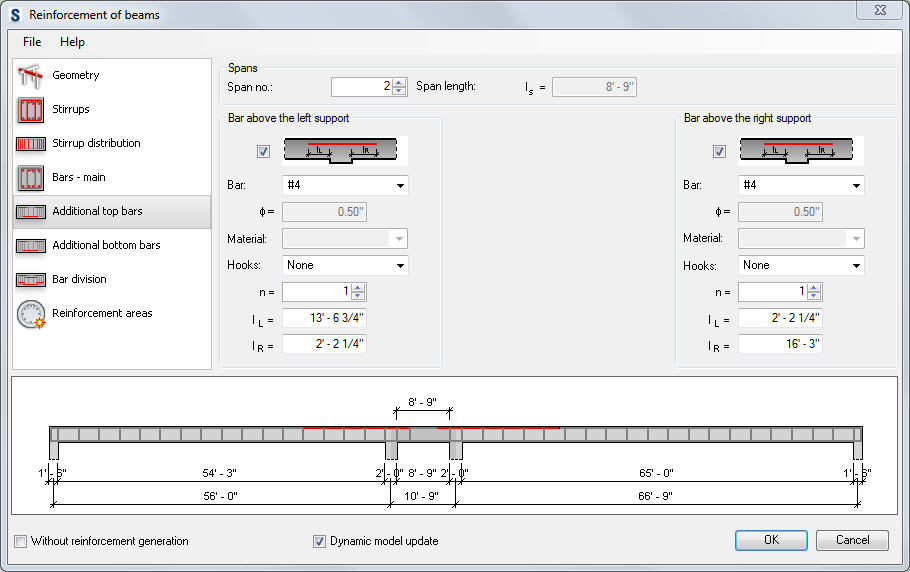

Using the following 2 tabs, you can define additional longitudinal bars.
Reinforcing bars are generated separately for each beam span. Parameters of these additional top bars include:
- Bar parameters
- Type, diameter, and material of bar
- Hooks
- Number and length of additional longitudinal bars

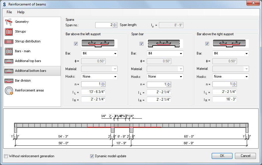

Additional bottom bars
These reinforcing bars are generated separately for each beam span. Parameters of these additional bottom bars include:
- Type of bar:
additional longitudinal bars above the left support in the span
additional longitudinal bars in the span
additional longitudinal bars above the right support in the span.
- Bar parameters
- Hooks
