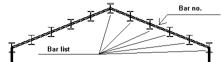

- Select the bar (the Position option in the Special values field and the Number option). The selected bars are turned in such a manner that one of the cross-section principal axes is perpendicular to the longitudinal axis of the highlighted bar. This option is useful when setting roof purlin bars. The consecutive stages for determining a Gamma angle for structure roof bars are shown in the following images.
Initial position of bars
After defining a Gamma angle, the following bars are selected:
- In the Bar List field, the numbers of all purlins are entered (See Bar list in the image.)
- In the Number field, the number of a bar is entered, which determines the rotation plane (See Bar no. in the image.)
Position of the bars after defining a Gamma angle.
