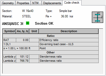

Click the Code Check tab in the Bar Properties dialog for an RC member (after calculation of reinforcement theoretical (required) area) to display the following:
The following information, that you cannot change, displays:
Results are displayed for the following RC member types:
The following information is displayed at the bottom of the dialog for individual RC member types:
