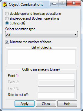

When the Cutting option is selected in the Object combinations dialog, the following displays:

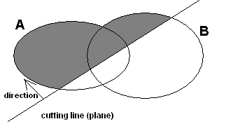

The option lets you determine the parts of the surfaces of the selected objects that are located on one side of a defined plane. The operation yields an object cut-off from the selected objects using a defined plane. Specify the direction in which the selected objects will be cut off in the Side to cut off box.
To perform this operation:
Robot creates a complex object based on the defined parameters. After the "<<" button is clicked, the Object Combinations dialog is enlarged and the definition of the newly-created complex object is entered in the additional field. The definition covers:
Successive complex objects are displayed in the form of a tree.
To restore the original size of the dialog, click the ">>" button.
You can also define additional parameters for creating complex objects. After the Advanced settings button is clicked, a dialog displays that allows you to define the additional parameters.
