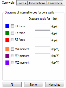

When the Core walls tab is selected on the Diagrams for buildings dialog, the following displays:

This dialog displays values for which the diagrams for the core walls will be presented.
For each of the values above, the appropriate color and scale can be selected.
Descriptions of directions (X, Y, Z) for the diagrams of forces and moments refer to the global coordinate system.
