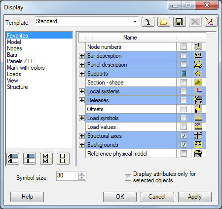

Attribute display
The Attribute display selects structure attributes to be presented on the screen. The dialog only displays if the .NET component is installed.
A template will display once selected from the available list in the upper part of the dialog.
The following tools are available in the upper part of the dialog.
- Loads a slected template with its settings.
- Opens the dialog for management of display templates.
- Saves settings in a selected template.
- Deletes a selected template in the list.
- Opens another dialog to enable the following.
The central part of the dialog has two panels:
Lines marked in blue indicate items to be displayed. Lines marked in white may include subgroups of blue lines.
Note: White lines are ascribed permanently to lines marked in blue and may not be transferred to other groups (they may be transferred within a given group).
Categories (marked with blue lines):
  1. Activation / Deactivation
    Deactivation - Selects all groups marked in white, belonging to that category
    Activation - Selects all groups marked in white, belonging directly to a selected category
  2. Sorting
    After clicking a column, it is sorted by the given contents.
    Alphabetically (Name).
    Selected options (Display).
    Sorting by selected options is a one-time operation, repeated by clicking the column heading.
At the bottom of the dialog there are the following options.
