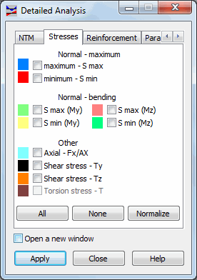

- NTM
- Stresses
- Reinforcement
- Parameters
- Division points.

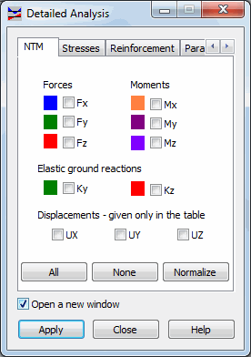

NTM, Stresses and Reinforcement select the quantities for the bars selected from a structure. The values of the selected quantities (displacements, internal forces, stresses, theoretical (required) or real (provided) values of reinforcement area or reinforcement ratio) will be presented graphically. They are visible in the viewer and the table. You can indicate several quantities to be presented simultaneously for the bars selected from a structure.
The NTM tab presents reactions of an elastic ground for bars (the options KY and KZ). The KY and KZ values are obtained as elastic ground reactions (R = K u, where R denotes force of reaction, K coefficient of elastic ground reaction, u displacement) along the bar length in the local system if elastic ground has been defined for the bar.
Note: Displacements selected on the NTM tab will be presented only in the table (not as diagrams).

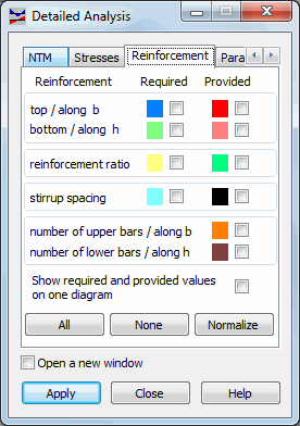

The Reinforcement tab of the Detailed Analysis dialog quantifies reinforcement for presentation.
- Theoretical (required) reinforcement - top reinforcement (along the side of b length), bottom reinforcement (along the side of h length).
- Real (provided) reinforcement - top reinforcement (along the side of b length), bottom reinforcement (along the side of h length).
- Theoretical (required) and real (provided) reinforcement ratio.
- Theoretical (required) and real (provided) stirrup spacing (for transversal reinforcement).
- Number to top bars (top reinforcement) along the side of b length.
- Number to top bars (bottom reinforcement) along the side of h length.
- Show theoretical (required) and real (provided) values on one diagram option. If enabled, one diagram for one quantity will show theoretical (required) and real (provided) values. If the option is disabled, all the values are presented on separate diagrams.

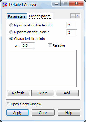

Options in the Division points tab include the following.
- You can indicate the points for which the values of relevant quantities will be presented in the table.
- If N points along bar length is selected, the number of points (the beginning and end node of the bar included) are defined and distributed along the length of the bar for which the relevant values are presented. The default value of N = 2. The table will present the values of the quantities selected for presentation only for the bar beginning and end. If N = 3, then a point will be added in the exact middle of the bar and the values of relevant quantities for the point will be presented.
- If the Characteristic option is checked, the user defined point on the selected bar (its absolute or relative distance to the bar beginning) for which the values of the relevant quantities are displayed. The successive points selected for presentation will be accompanied by the following descriptions.
- Auto - Points generated automatically
- Defin. - User defined points
- Zero - Characteristic points on the bar (where the value of the selected quantity equals zero and the extremes of the selected quantity).
- Refresh button - Refreshes the list of points (if changed by the user) for which the values of indicated quantities are to be presented.
- Delete button - Deletes points on a bar for which the values of indicated quantities are no longer to be presented.
- Add button - Adds points on a bar for which the values of indicated quantities are to be presented.
