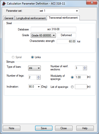

The Transversal reinforcement tab allows you to define the parameters of transversal reinforcement of an RC member according to the ACI 318 codes.
Access
- Click Design
Required Reinforcement of Beams/Columns - Options
Calculation Parameters to open the Calculation Parameters dialog, and then click
- Click
(RC Member calculation parameters) to open the Calculation Parameters dialog, and then click
Dialog elements
- Steel
- Select the grade of the defined steel.
- Stirrups
- Defines the parameters of stirrup reinforcement.
- Type of bars - select the diameter of reinforcing bars for a stirrup.,
- Number of legs - specify the number of legs of stirrups,
- Inclination - specify the angle between longitudinal and transversal reinforcement; a list of choice contains the following angle values: 90, 65,5 and 45 degrees.
- Number of reinforcement sections - specify the maximum number of sections to which stirrup spacings are assigned. For each section a spacing of stirrups is uniform.
- Modularity of spacings - specify the list of stirrup spacings by modularity value. If a Modularity of spacings is defined as 2" , the accessible spacings are 2,4,6,8 etc., and for Modularity of spacings as 0,5", the accessible spacings are 0.5, 1, 1.5, 2.0...
- List of spacings - specify the list of defined stirrup spacings not linked with any modular value for element reinforcement. For example 1 ,2 ,3 ,6 , and 9.
- Calculation method
- Select the calculation method from the following options:
- standard - a standard truss method 4.3.2.4.3,
- strut inclinations - a truss method with diagonals with variable inclination angle 4.3.2.4.4.
Note: This option is available for the ENV 1992-1-1 older edition code with different National Application Documents.
