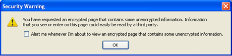

Security Warning
If you are using the Mozilla Firefox web browser, you may see the following warning when you start downloading an Autodesk product:
If you see this warning, click the OK button to close the warning and allow the download to continue. If you do not click OK within 10 seconds, the download can be interrupted. In this case, restart the download and be ready to click the OK button if you see the security warning again.
