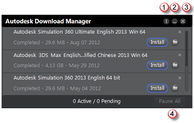

Main Window Controls
Control Function
1
Presents information about Autodesk DLM, including links to Help and the License and Services Agreement.
2
Minimizes DLM to the Windows Taskbar (lower right corner of your screen); any active downloads continue.
3
Closes DLM and pauses all active downloads.
4
Pauses all active downloads, or as Resume All, resumes all paused downloads. Pausing the downloads is useful when you need more computer processing capacity for another task.
If you close DLM and later want to resume the downloads from where they stopped, relaunch DLM from the Start menu (Start > All Programs > Autodesk > Autodesk Download Manager). When DLM launches, click Resume All. If DLM was closed with less than 700 MB downloaded, the download might restart from the beginning.
You can use the cursor to resize the DLM panel and move it outside your work area.
