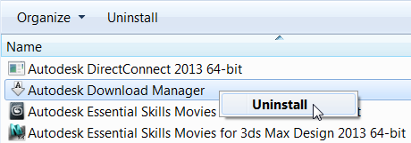

  1. Click Windows Start menu Control Panel Uninstall a Program.
  2. On the program list, right-click Autodesk Download Manager Uninstall.
  3. On the same program list, right-click Akamai NetSession Interface Uninstall/Change Uninstall.
