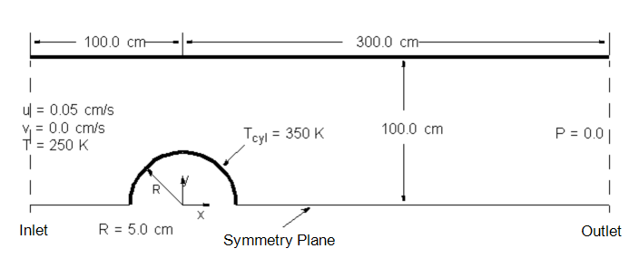

Problem Description
A circular cylinder with an infinitely long axis (thus approximated as 2D) is immersed in a laminar flow with a Reynolds number of 50 (based on the diameter of the cylinder). The cylinder wall has a fixed temperature 100 K higher than the fluid bulk temperature. This model is analyzed to verify the fluid flow and heat transfer modeling capabilities of Autodesk Simulation CFD.

Geometry and Boundary Conditions

Using Re=50 (based on cylinder diameter), Q=17.08 watts, Pr=6.97, and the known geometry and boundary condition data, the following results are computed:
Benchmark 2014: Build 20130102 % Error 2015: Build 20131223 % Error
Nue = 8.29 Nua = 8.229 0.735 Nua = 8.228 0.742
