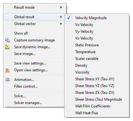

The Global Result

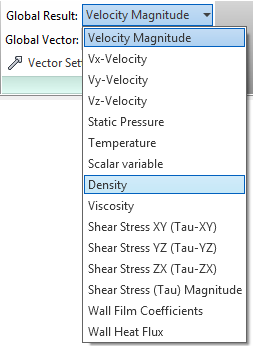

To specify the result quantity displayed on model surfaces, right click, and select Global result:
Alternatively, select from the Global Result menu on the Global context panel:
The global result is reflected in the Legend in the graphics window. Changing the units of the Legend changes the output units when probing.
This also sets the result quantity displayed in the Status Bar when probing with the mouse. (To probe, hold the Ctrl and Shift keys and hover the mouse over the location of interest.)

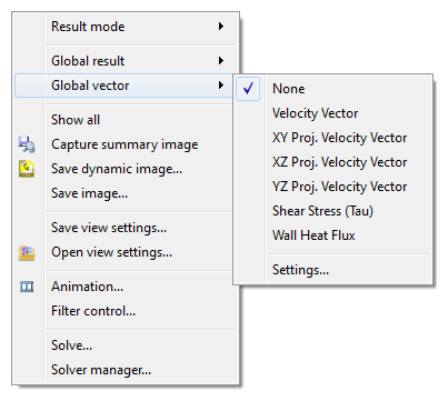

The Global Vector
To display vectors on all fluid surfaces (inlets, outlets, and internal surfaces between fluid regions), right click and select Global vector. Select the desired quantity from the expanding menu list.
Use the Settings… dialog to control vector attributes such as length and arrowhead size.
Alternatively, select from the Global Vector menu on the Global context panel.

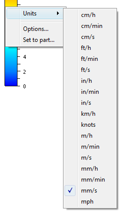

To change the units:

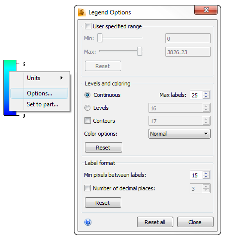

To change the appearance, range, and settings:
To change displayed units
Right-click on the legend, and select Units.
To modify legend appearance
Right click on the legend, and click Options.
To change the range
  1. Check User specified range.
  2. Adjust the range with the Min and Max sliders.
Note: To increase the range, key in a value in the field adjacent to the appropriate slider.
Levels and Coloring
Label spacing and format
Legend vertical spacing
To control the maximum number of legends that can be displayed vertically, click View > Appearance > Legend, and change the value in the spin-box control:

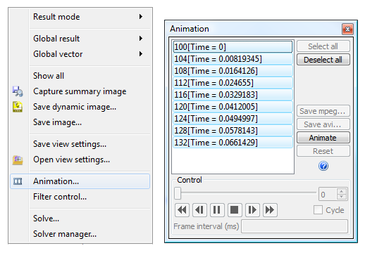

Alternatively, click Results (tab) > Image (panel) > Animation to open the Animation dialog.
Use the Animation dialog to animate saved iterations or time-steps.
To open the Animation dialog
To animate results sets
  1. To select steps, click on them from the list.
  2. Click the Animate button.
  3. Use the "VCR" controls to control the animation.
  4. To finish animating, click the Reset button.

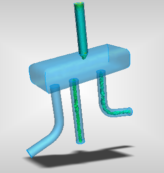

Use Filtering to visualize where a result quantity occurs within a specified range.
Some examples where Filtering is very useful include:
Filtering is conceptually similar to Iso Surfaces, with two important differences:
  1. Instead of a surface that is based on a single results value, Filtering shows a volume that is based on a range of results values.
  2. In addition to the Filter volume, the entire model is displayed. This makes it easier to identify the location of the region relative to the entire design.
While Filtering is enabled, the primary display controls (on the View toolbar) affect the filter volume.
To enable Filtering
To change the Filter range
To change the Filter volume appearance
To change the model appearance
By default, the model is displayed transparently.
