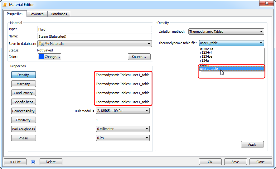

The .dat files contain property information for saturated, superheated, and sub-cooled fluids. They are located in the top-level folder of your Autodesk Simulation CFD installation and you can view the contents with any text editor. For example, in Windows 7, ProgramData\Autodesk\Simulation CFD <version>.
Each thermodynamic table file is divided into five sections:

Vapor and Liquid Properties
Default values for viscosity, specific heat, and thermal conductivity are average values across the vapor and liquid portions of the saturated table, respectively. Each line contains the following data:
