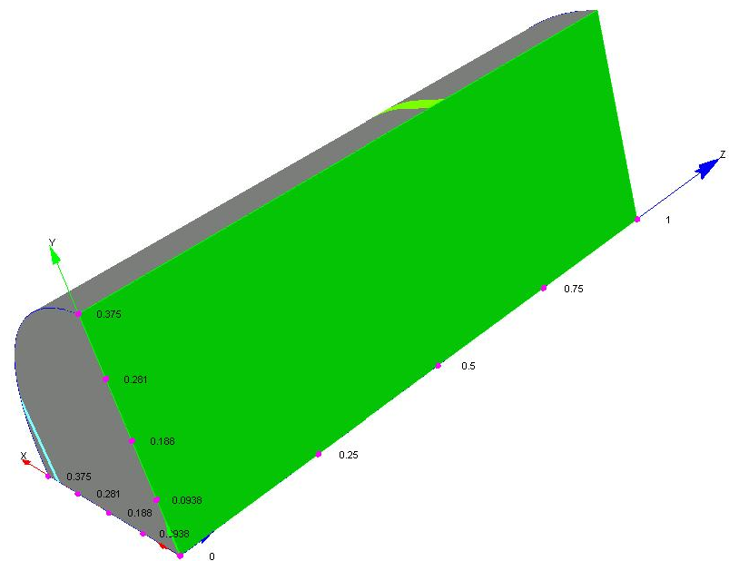

Problem Description
This model is Example 6.5 in the reference. The objective is to determine the centerline temperature of a bare steel wire carrying a current and exposed to ambient air. The wire has a resistance of 0.0001 Ohms-mm.
Geometry and Boundary Conditions
The radius of the wire is 0.375 inches, and the length is 1 inch.
A current of 250 (1000/4) Amps is applied to one end. A reference voltage of 0 volts was applied to the opposite end. A film coefficient of 5.0 Btu/hr-ft2-R and an ambient temperature of 70 F is applied to the outside edge of the wire.
