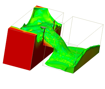

Example of a Free Surface Simulation
At the start of this example, the reservoir on the left is full, and the one on the right is empty. The reservoirs are separated by a retaining wall with a gate cut-out to allow water to pass between the reservoirs.
Geometry: The two reservoirs and the pass-through gate were created as separate parts in the CAD system.
Materials: Water is assigned to all three parts.
Boundary Conditions: There are no inlets or outlets because the flow is contained within the domain. No boundary conditions are applied. Note that a pressure condition is automatically applied at the liquid-air interface, so it is not necessary to apply an additional pressure boundary condition in this model.
Initial Conditions: Because the reservoir on the left starts full of water, apply the HOF initial condition to it.
Mesh Sizing: Use Automatic Sizing, but refine the mesh where the air and water will interact. In this case, that is primarily in the gate and in the right-side reservoir.
Solve:
- On the Physics tab of the Solve dialog, click Free surface, and check Enable free surface.
- Specify a gravity vector. In this case, gravity acts in the -Z direction, so set the Earth gravity directional unit vector to 0,0,-1.
- On the Control tab, the Solution Mode is automatically set to Transient, and the Time Step Size is automatically set to 0.01.
- If you wish to animate the results, specify a value for Save Intervals > Results.
- Specify the number of time steps (1400 were used for this simulation), and click Solve.
Results:
- To view the shape of the flow, right click off the model, and click Free Surface.
- To animate the filling process, right click off the model, and Animation. On the Animation dialog, click Animate, and the Play button. (If you do not specify a value for results Save Intervals, you will only be able to see the last time step in the simulation.
As you can see, the water flows from the left reservoir into the right reservoir until the water level in the two is the same.
