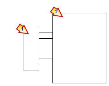

Build the heat exchanger (1) so that it is not immersed within the system (2)
Construct a volume at the inlet (1) and outlet (2) to offset the device from the system
The heat exchanger should not touch the system. The material of both extensions should be the system working fluid.

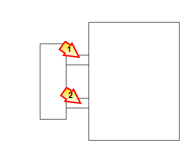

Construct the inlet (1) and outlet (2) with a single, separate, planar surface
Note: Openings consisting of multiple surfaces are not supported.
At the conclusion of the simulation, the Heat exchanger openings are listed in the Summary file as system openings:
- Heat exchanger inlets appear as a model outlets (pressure = 0).
- Heat exchanger outlets appear as a model inlets (volume flow rate).
