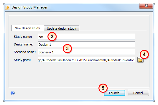

To create a new Design Study by launching from CAD
  1. Start by clicking the CFD launch button or menu item.
  2. Specify a name for the Design Study in the Study name field. The default name is the name of the top level assembly or the part.
  3. Optionally, change the Design and Scenario names from the defaults.
  4. The default location of the study is the same path as the CAD model. To change this, click Set path..., and select (or create if necessary) the desired path.
  5. Click Launch. Autodesk Simulation CFD starts, and the Design Study is created. The first Design and Scenario are listed in the Design Study Bar.
