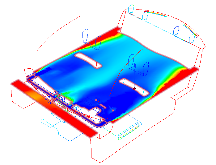

1. To view the air flow out of the front registers, left click on the results plane and select the Y icon. Then drag the plane so that it passes through the registers as shown.
Note: Notice the warmer areas in the center and near the sides of the rear seat.

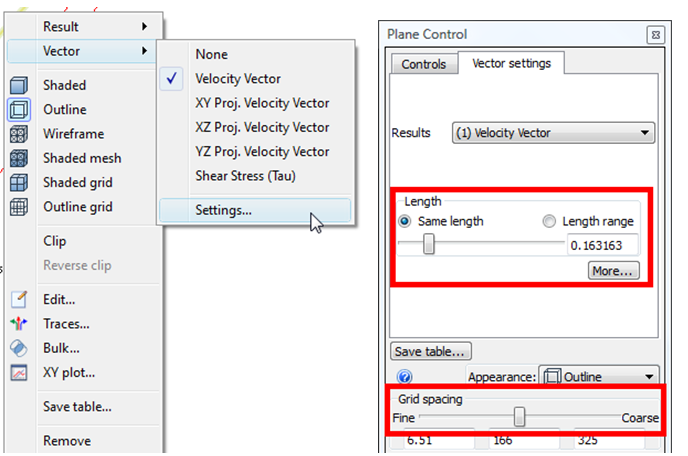

7. Right click on the plane, and click Vector, and Settings. Modify the vector length and spacing on the Vector settings tab of the Plane control dialog.
8. Note the flow distribution, including areas of recirculation near the front seats:

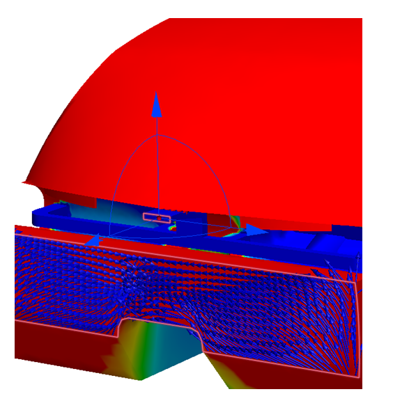

9. Left click on the results plane and select the X icon. Drag the plane to the center of the car:
Note: Note the recirculation near the lower part of the windshield.
10. Create a view of this flow that includes the shaded geometry. Select Shaded from the Quick Access toolbar:

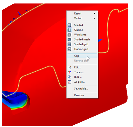

11. Right click on the results plane and select Clip.
12. If the "other" side of the model is showing, right click on the plane again and choose Reverse Clip.
Note: Clipping improves visibility of specific model regions, and is a powerful way to display vectors when the model is shaded.

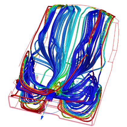

17. To study the flow in 3D, click Traces... from the Planes context panel.
18. In the Traces dialog, select Rectangular grid as the Seeding method. Set Rows to 30 and Columns to 6. Click Add points.
19. Click the upper left corner of the inlet (1), click the upper right corner (2), and click the lower right corner (3):
Note: The image above displays the model transparently, to aid visibility.
20. Click Add trace set.

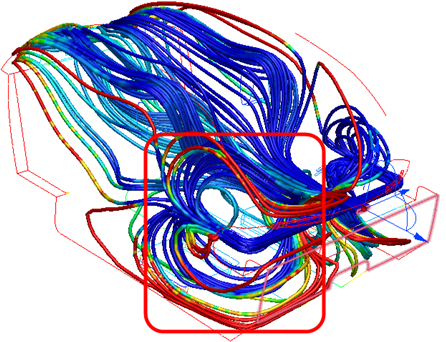

21. Display the view in Outline mode.
22. Observe recirculation in front of the seat. This prevents air from reaching the rear seat area.
Note: Traces are colored by the Global Result. In the image above, they are colored by Static Temperature.
23. Note that the majority of flow that reaches the rear seat comes from the center of the cabin. Right click off the model and select Capture summary image.

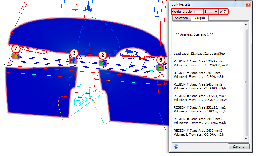

27. Drag the normal axis of the cut plane triad to position the plane through the four front registers as shown:

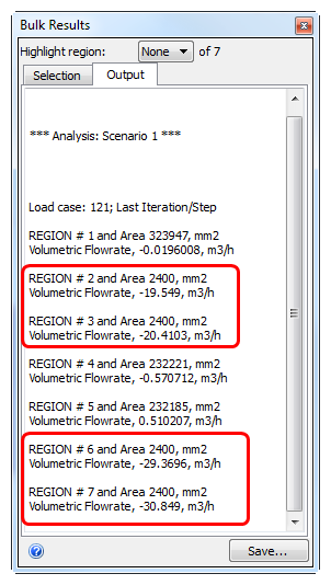

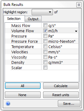

28. Compare the flow balance between the two four registers: Select Bulk from the Planes context panel. Select Volume Flow. Click on the adjacent units field, and select m3/h.
29. Click Calculate.
30. Select regions from the Highlight region menu to identify the distinct registers.
Note: This results plane is divided into 7 distinct regions. Autodesk Simulation CFD numbers these regions. To highlight the corresponding region in yellow on the plane, select the corresponding number from the Highlight region menu. Use this method to identify the regions of interest. In the image above, the regions are 2, 3, 6, and 7, but these numbers may differ for your model.
31. Observe the flow rates from all four registers. Note that the two interior registers (regions 2 and 3) each provide 20 m3/h of air while the exterior registers (regions 6 and 7) each provide 30 m3/h.
