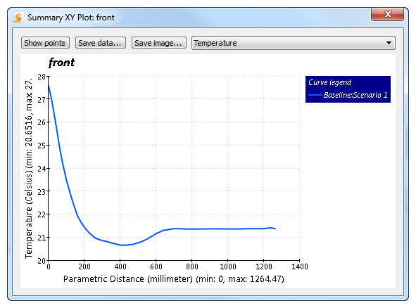

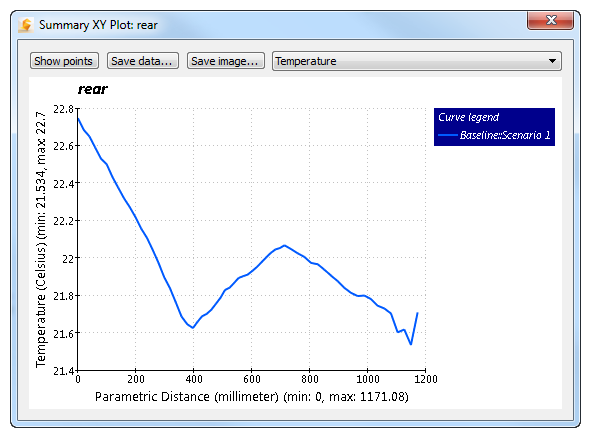

3. To plot temperature for the front and rear occupants, click on each XY plot in the Decision Center:
Note: These plots reveal the following observations:
4. Close both XY plots.

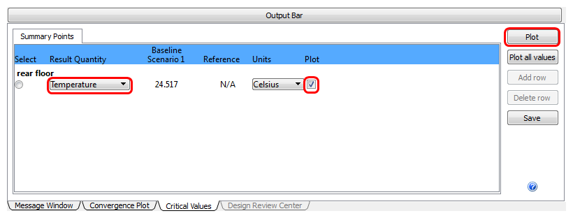

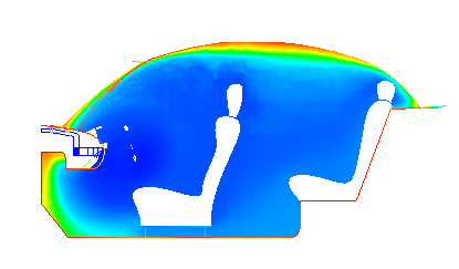

5. Left click on the "rear floor" summary point in the Decision Center:

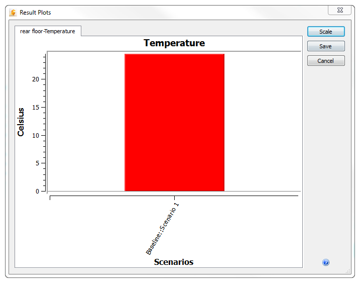

6. In the Critical Values tab of the Output Bar, select Static Temperature. Check the Plot box and click the Plot button:
Note: Note the temperature at this location.
7. Close the plot window by clicking the "X" in the top right corner of the dialog.

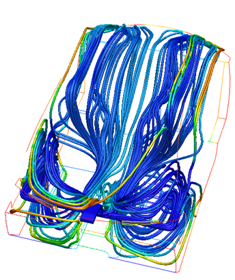

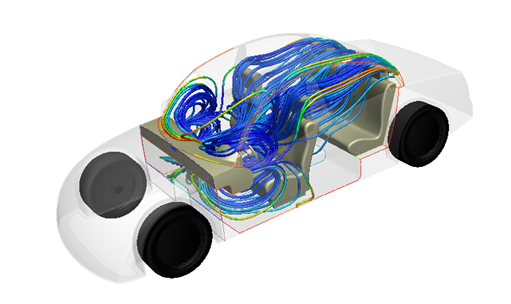

8. To show each summary image, click each entry in the Design Review Center of the Decision Center.
9. Right click on each image in the Decision Center, and rename the images as shown:
Conclusion
The results indicate an uneven temperature distribution and poor airflow performance near the floor. We will analyze a modified design configuration to attempt to resolve these issues.
