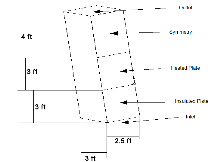

Geometry and Boundary Conditions
The unmarked surfaces are symmetry surfaces. The vertical plate starts at the inlet and is not heated for the first 3 feet. This allows the thermal boundary layer to grow separately from the momentum boundary layer.
The inlet temperature is 70°F. The temperature of the heated portion of the plate is 105°F.
