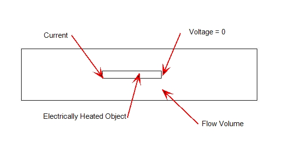

Two boundary conditions are available to define a Joule heating condition: Current and Voltage. The typical way to define the loading is to assign a current on one end of the solid or surface part through which electricity is passing and a voltage of 0 on the other end:

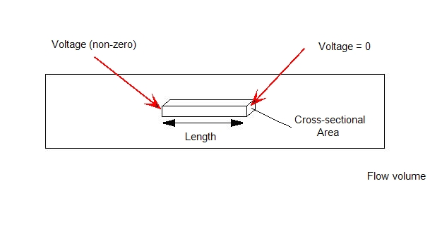

Alternatively, a potential (voltage) difference can be applied across the device by specifying a non-zero voltage on one end and a zero-value voltage on the other. In this case, the current boundary condition is omitted.
The Resistivity material property is the product of the resistance and the cross-sectional area divided by the length of the part. A value for resistivity is required for any solid that is heated by the Joule effect.
Resistivity
A non-zero value for resistivity should always be specified for solids and surface parts in which Joule heating occurs.
Note: For surface parts, use a unit depth when computing A, the cross sectional area.
