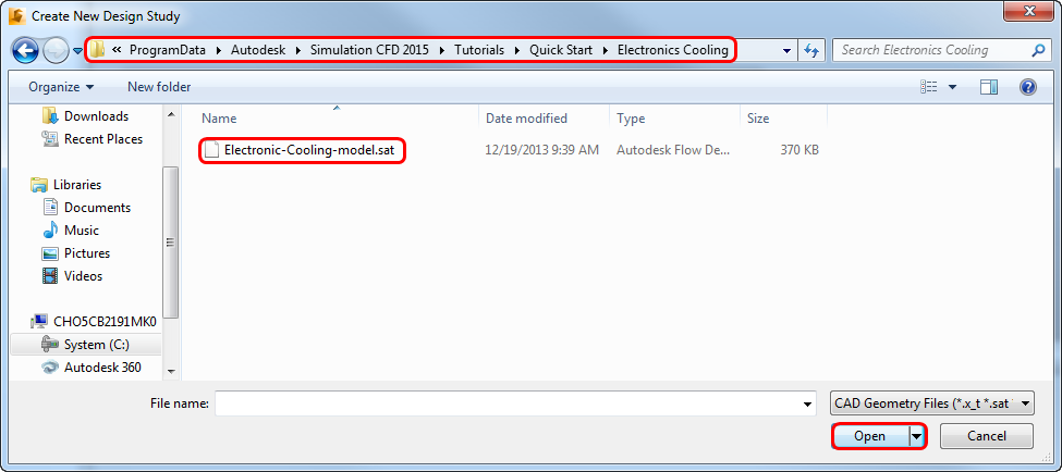

1. Start Simulation CFD, and click New.
2. On the New Design Study dialog, click Browse...
3. Navigate to C:\ProgramData\Autodesk\Simulation CFD 2015\Tutorials\Quick Start\Electronics Cooling, and select Electronic-Cooling-model.sat. Click Open.
Can't find the ProgramData folder?
Open a file browser window (Start menu > Computer).
From the top left corner, click Organize > Folder and search options.
Click the View tab.
Select the Show hidden files, folder, and drives option.
Click Ok.

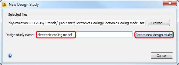

4. On the New Design Study dialog, enter a name for the Design study name, and click Create new design study:

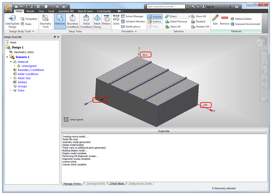

5. The geometry imports in units of meters, but we need to convert it to mm. To do this:
What it should look like:
Autodesk Simulation CFD starts, and you should see the model. Note the dimension values on the axes:
