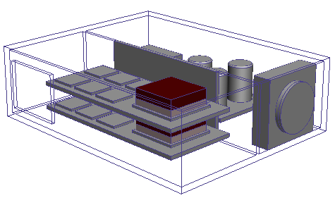

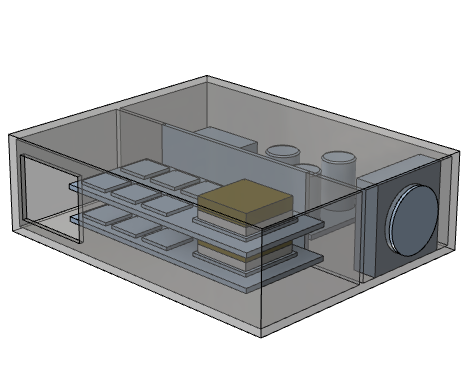

The following image shows the electronics assembly, from the Electronics tutorial, with some transparent walls.

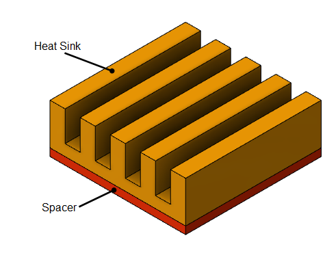

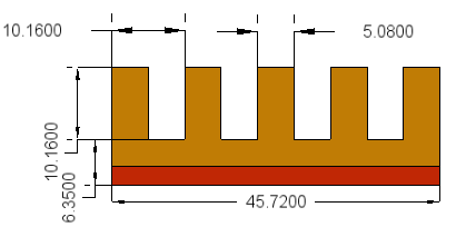

There are two of the same Printed Circuit Boards (PCB) in the assembly. Each PCB has a chip cooled by an aluminum heat sink. The heat sink is attached to the chip using a solid aluminum spacer with the same footprint as the heat sink.
Note: The heat sink / spacer footprint is square. That is, the width and depth are equal (45.7200).

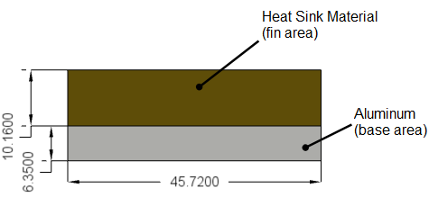

To apply a heat sink material, first replace the modeled heat sinks and spacers with simplified geometry in your CAD model. Since the modeled heat sinks have a thick base plate, a two-part block assembly is appropriate (see Heat Sinks for details on choosing single blocks or two-block assemblies). The top block represents the finned area while the bottom block represents the base plate and spacer. The two-part assembly has the same envelope dimensions as the combined heat sink and spacer.

    • Set Base thickness to 0 and click Apply. With a two-part assembly, the base area is explicitly modeled by the solid aluminum block. As a result, you do not want the heat sink material correlation to include base effects.

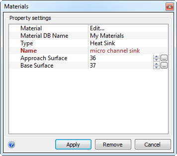

  6. In the Materials dialog:
    • Verify that the Name is micro channel sink.
    • Click the number for the Approach Surface. The Approach Surface dialog opens.

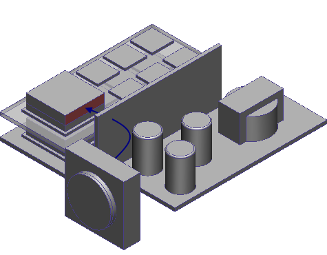

    • Click Select Surface and choose the upstream or approach surface. For this example, air flow passes through the center baffle and approaches the surface as shown in the following figure.
    • Click the number for the Base Surface. The Base Surface dialog opens.
    • Click Select Surface and choose the surface that interfaces with the aluminum base area block.
    • Click Apply.

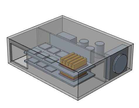

The following figure displays the electronics assembly with the micro channel sink material and aluminum assigned to the fin and base areas, respectively.
