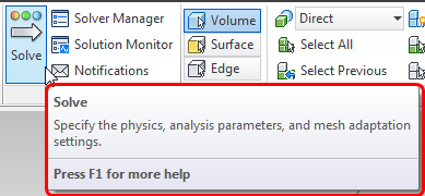

Tooltips
The most basic and direct source of information is the tooltip. To view a tooltip, hover over a control or button in the Ribbon, Quick Access toolbar, Design Study bar, or the InfoCenter. The tooltip contains a brief description of the control and often describes its use.
Here is the tooltip for the Solve command:

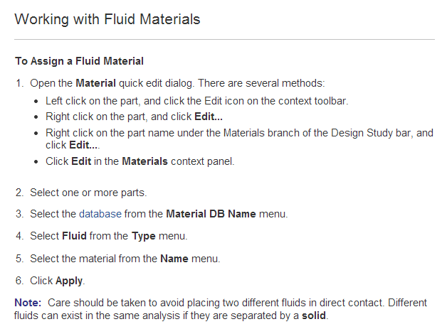

To learn more about the control, press F1 on the keyboard to open the specific topic in the Help system.

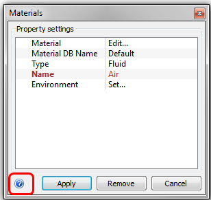

Help Icons
Almost every dialog contains a Help icon. Click the Help icon to open the Help topic that describes the operation of the dialog.
When the Help icon shown above is clicked, the following topic opens:
The information in the Help is a combination of procedures, description, application-specific guidelines, and theory.

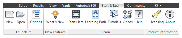

Start & Learn Tab
The Start & Learn tab contains links to several Help resources:
InfoCenter
You can also click the Help icon in the InfoCenter to open the Help:

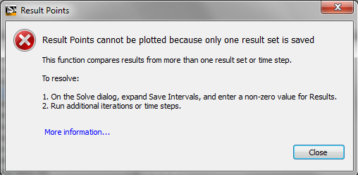

Errors
When an error occurs, a dialog box opens that presents the error message, a brief description, and a steps to resolve the problem. To learn more about the issue, simply click "More Information" to initiate a search within the Help system installed with the product:
