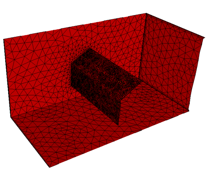

Surface Parts are useful because they eliminate the need to model very thin geometry with three dimensional volumes. Meshing such volumes can be very difficult and can result in very large model sizes. The reason is that an element that is small enough to represent the thickness will be so small that a huge number of them are required across the other dimensions of the object. By representing such objects only with surfaces, the elements only need to be small enough to represent the shape of the object, eliminating the thickness from the model.

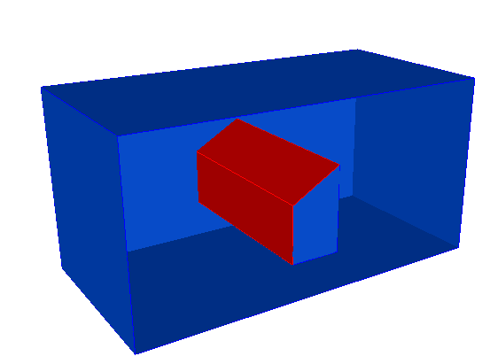

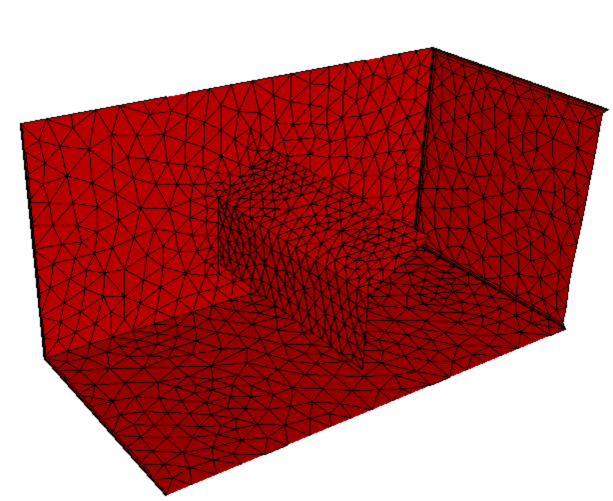

The following model contains a thin-walled obstruction that is modeled as a volume. The element size needed to represent this volume is quite small (because the part is so thin), so the element count is large (about 158,000 elements).

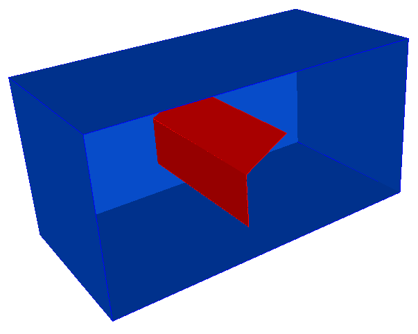

This model, however, uses a Surface Part to represent the thin obstruction. The element size on the surface part is not vastly different from that of the surrounding air, and the overall element count (model size) is considerably smaller (about 38,000 elements):

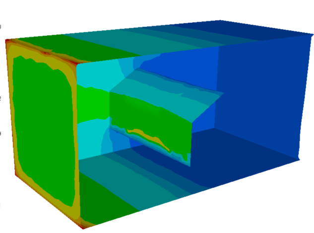

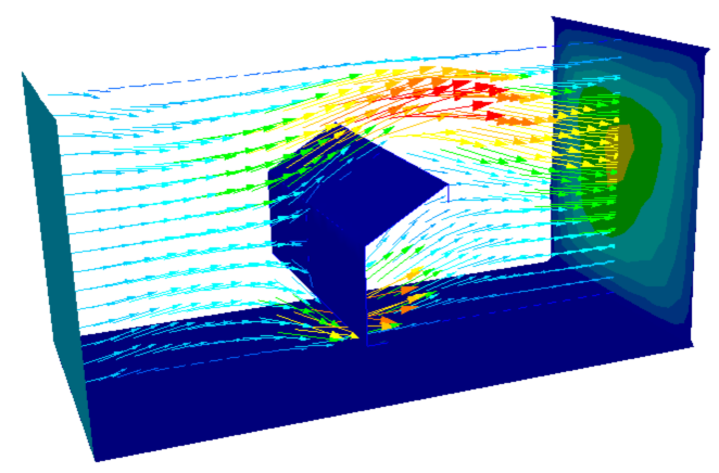

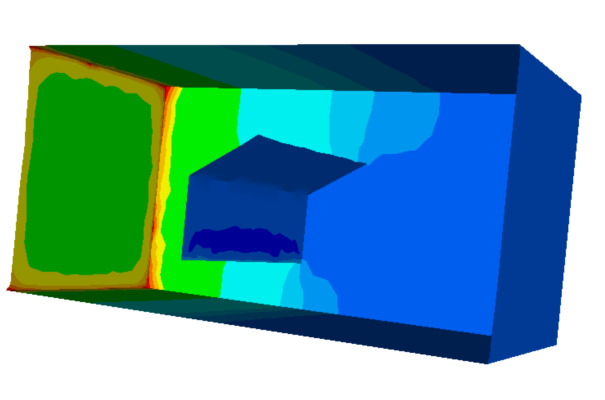

The standard visualization tools in Autodesk Simulation CFD work with Surface Parts. Cutting planes and iso surfaces will display results caused by the presence of Surface Parts. Using shift+ctrl, results on Surface Parts can be probed by hovering the mouse.
The displayed value of pressure on Surface Parts depends on which side of the Surface Part is viewed. The leading side of a Surface Part will show high pressure, and the wake side will show lower pressure:
