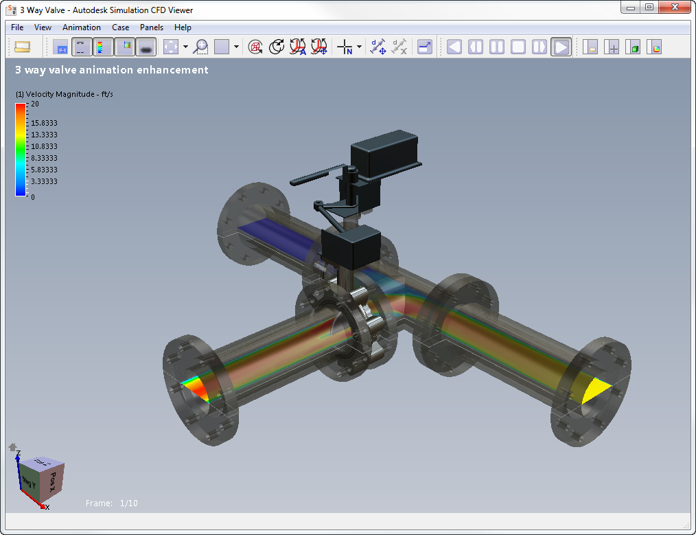

The Autodesk® Simulation CFD Viewer is shown with a results set loaded:

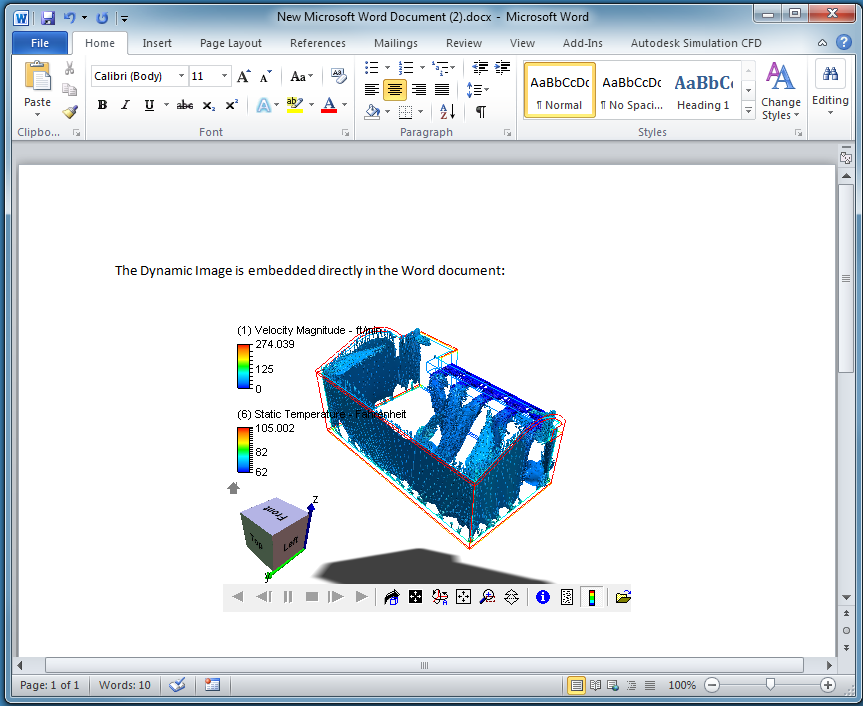

The Simulation CFD 3D Viewer has connections to Microsoft® PowerPoint and Microsoft® Word. These enable Dynamic Images to be a part of your Office presentations and documents.

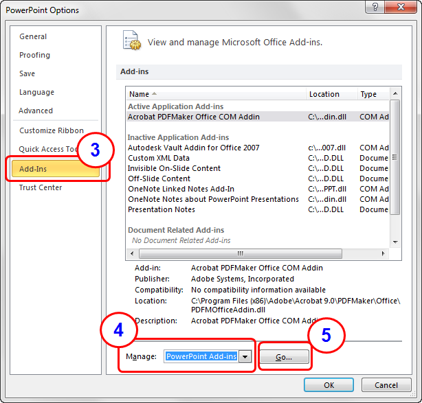

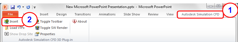

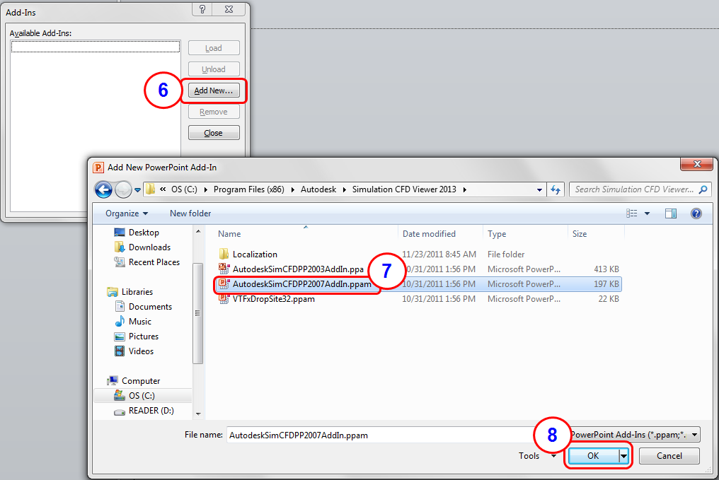

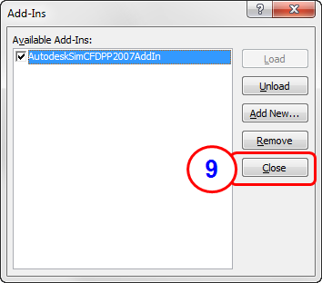

To add the CFD Viewer Addin
Before adding a Dynamic Image for the first time, add the CFD Viewer AddIn:

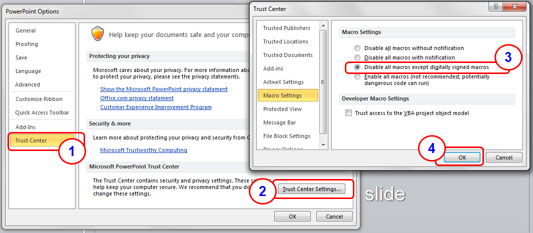

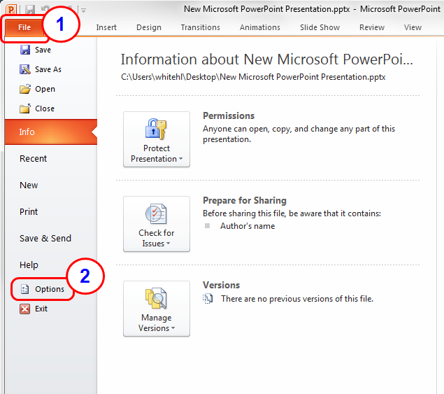

If the button does not appear, reduce the PowerPoint security settings:

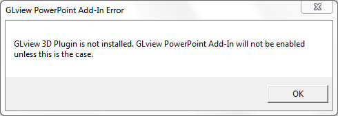

If you see the following error, the required plug in is not installed on your computer:
To download and install the free plugin, click this link: http://ceetron.com/products/end-user-products/glview-3d-plugin. Note that this opens to the Ceetron® website.

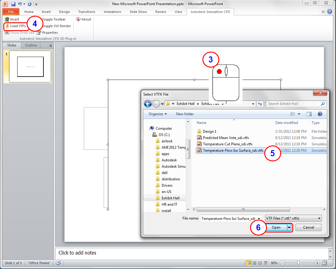

To add a Dynamic Image:

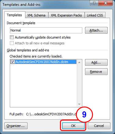

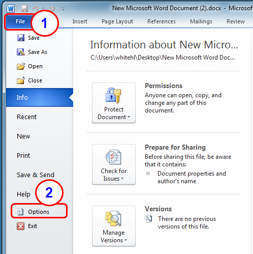

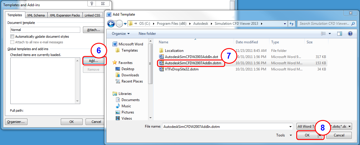

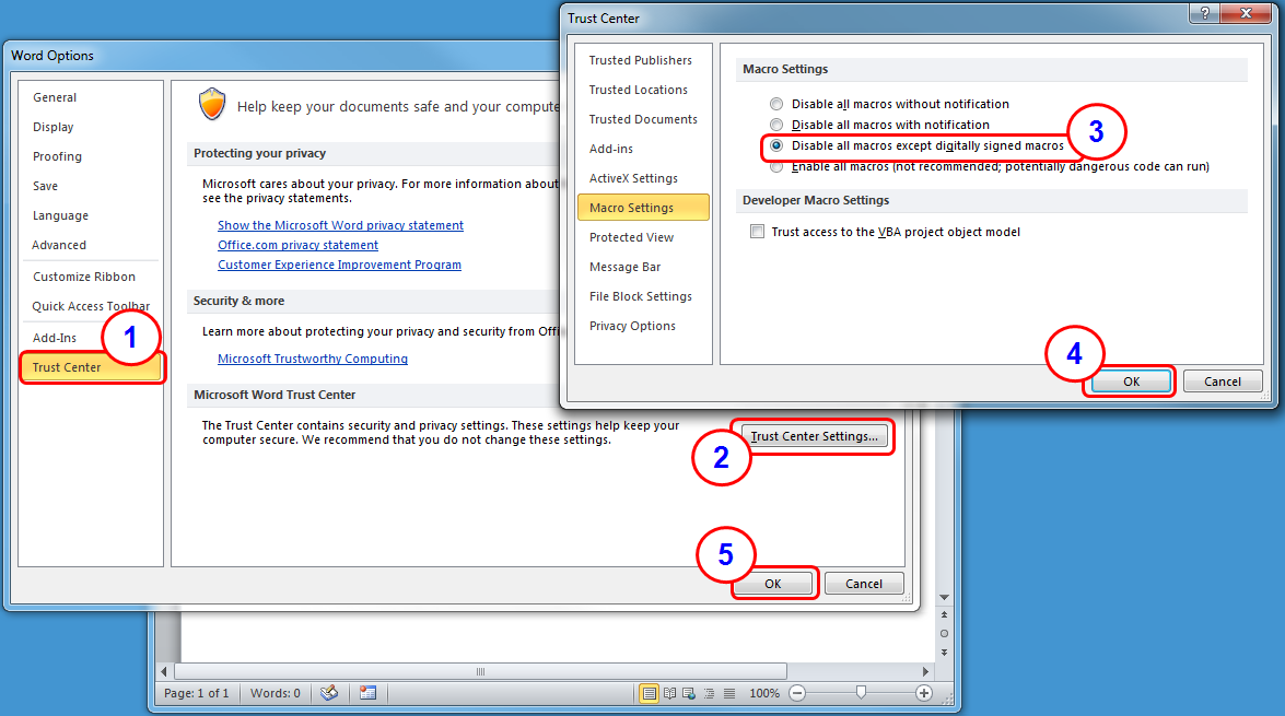

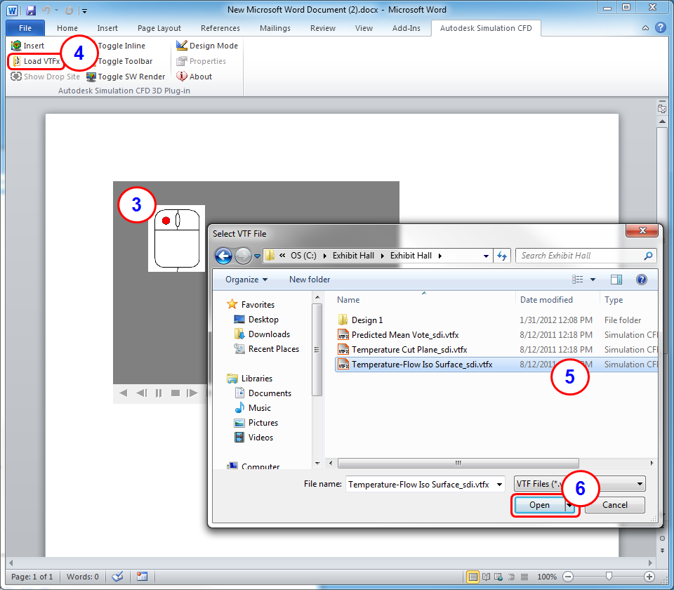

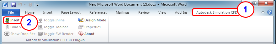

If the button does not appear, reduce the Word security settings:
