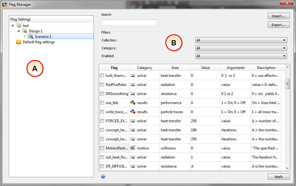

The Flag Manager dialog contains two primary panes:
- The Flag Settings pane is on the left. This shows which flags are selected as Default flags and which are active in the scenario.
- The Flag List pane is on the right. This is the complete list of flags.

To add a flag to a collection:
- View the complete list of flags: click Default flag settings from Flag Settings pane.
- If no collections exist, click New collection..., and create one.
- In the Flag List, right click on a flag name, and click Add to collection. Select the collection from the list.
Searching
Flags are organized by functional Category, and Area. There are several ways to find a specific flag:
- If you know the first word or two of the flag name, enter them in the Search field.
- Narrow your search to a specific functional classification by selecting from the Category menu.
- If you have flags enabled, display them by selecting Enabled from the Enabled menu.
- If you have collections, select from the Collection menu. This lists only the flags in the selected collection.
Default Flags
Use Default flags in the Flag Settings pane to define settings that are invoked automatically for every new scenario.
To select a flag to be enabled by default:
- To activate a flag, check the box to the left of the flag name in the Flag List pane.
- Specify the value in the Value column.
- Click Apply.
When a new scenario is created, all default flags are listed under Default flag settings.
Default Solver- and Mesh- type flags are also listed under each Scenario because they affect how the scenario runs. To modify a default Solver or Mesh flag for a particular scenario, modify the scenario entry, not the Default entry.
