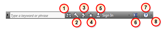

The InfoCenter is located in the top, right corner of the User Interface. It is your connection to Autodesk® information and news resources.
Use the InfoCenter to:
The InfoCenter tools are summarized:
1. Search
Enter keywords or a phrase in the InfoCenter box to search the Help content for information.
2. Subscription Center
Click Subscription Center to display links to information about subscription services such as product enhancements and personalized web support from Autodesk technical experts. To learn more about Autodesk subscription membership, visit http://www.autodesk.com/subscription.
Subscription services are available to subscription members only (available in countries/regions where Autodesk subscriptions are offered).
3. Communication Center
Communication Center provides the following types of announcements:
To receive new Information Notifications
Communication Center Online Policy
Communication Center is an interactive feature that must be connected to the Internet in order to deliver content and information. Each time Communication Center is connected, it sends your information to Autodesk so that you receive the correct information. All information is sent anonymously to Autodesk to maintain your privacy.
Communication Center sends the following information to Autodesk:
Autodesk compiles statistics using the information sent from Communication Center to monitor how it is being used and how it can be improved. Autodesk maintains information provided by or collected from you in accordance with the company's published privacy policy, which is available at http://www.autodesk.com/privacy.
You can specify Communication Center settings iin the InfoCenter Settings dialog. For more information, click here.
4. Favorites
Click Favorites to display saved links to topics or web locations.
Any link that displays on the Search Results panel, Subscription Center or Communication Center panel can be marked as a favorite.
A link marked as a favorite displays a star icon on the Search Results panel, Subscription Center panel or the Communication Center panel.
To display the InfoCenter Favorites panel
Click Favorites in the InfoCenter.
To save a link in InfoCenter as a favorite
To remove a favorite link from the InfoCenter Favorites panel
5. Autodesk 360 Sign In
Sign in to Autodesk 360 to access on-line services that integrate with your desktop software. You can login here prior to saving your simulation results to Autodesk 360. To learn more about Autodesk 360, click here.
6. Autodesk Exchange Apps
The Autodesk Exchange Apps is a storefront for Autodesk Simulation CFD. It provides Autodesk Simulation CFD users a single place to find and download application-specific tools and content (Apps). The Autodesk Exchange Apps is a community-building tool that provides a simple way to get tools and content to increase productivity. It is a showcase of the Autodesk® Simulation CFD application and content ecosystem at work.
The Autodesk Exchange Apps experience is built upon the concept of Autodesk Apps. These are tools developed by Autodesk, customers, and developers. Each App is carefully checked to confirm that it delivers the intended functionality with as high a level of quality as possible.
Autodesk Exchange App Manager
Use the Autodesk Exchange App Manager to track Apps downloaded from the App Exchange. Available information includes the name, version, source, date installed, size, and status.
The Autodesk Exchange App Manager is included in the Simulation CFD installation folder. Launch from the Start menu (All Programs\Autodesk\Autodesk Simulation CFD\ Autodesk Exchange App Manager.)
Autodesk Exchange Apps Site...
Apps are available for download from the Autodesk Exchange App Site. To access the App Exchange, click the Autodesk Exchange Apps icon from the InfoCenter. The icon shown in the graphic indicates that no updates are available for the apps you currently have. When updates are available, this icon is displayed instead:
7. Help
Click Help to open the Autodesk Simulation CFD Help system.
8. Product Information and CIP
Access two additional resources with the drop-arrow to the right of the Help icon: About and CIP:
