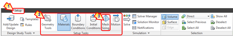

The Ribbon controls appear near the top of the User Interface. Use them for all stages of the simulation. The Ribbon consists of four separate tabs, and each tab is divided into panels. Each panel contains one or more functionally-related controls. Several controls activate specific setup- or results-specific tasks. These tasks spawn a context-sensitive panel that contains several often-used controls associated with the task. The Ribbon also has several customizable features, and a system of keyboard-based commands called Key Tips.
Each ribbon follows a simple hierarchal structure:
Throughout the Autodesk Simulation CFD Help topics, procedures refer to specific commands from the ribbon. To ensure clarity, each reference consists of the tab name, followed by the panel name, followed by the command name (Tab > Panel > Command).
For example, this is the reference to the Solver Manager command in the Simulation panel of the Setup tab:
Setup (tab) > Simulation (panel) > Solver Manager.
