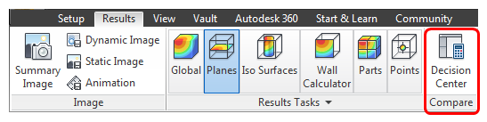

After capturing Summary items, compare them in the Decision Center. To open the Decision Center, click Results > Compare > Decision Center

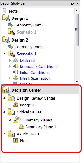

The Decision Center appears in the lower half of the Design Study Bar:

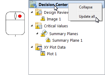

The  symbol means that a Summary item either has not been mapped to the other scenarios or that the results have changed since the last time it was mapped. The easiest way to map or update the Summary item is to right click on Decision Center, and click Update all:
You can update individual Summary items by right clicking on them and selecting the appropriate update command.

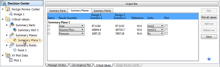

Use Critical Values to compare data from Summary Planes, Summary Points, and Summary Parts. To view the Critical Values table, click on a summary entity in the Decision Center or click the Critical Values tab in the Output bar.

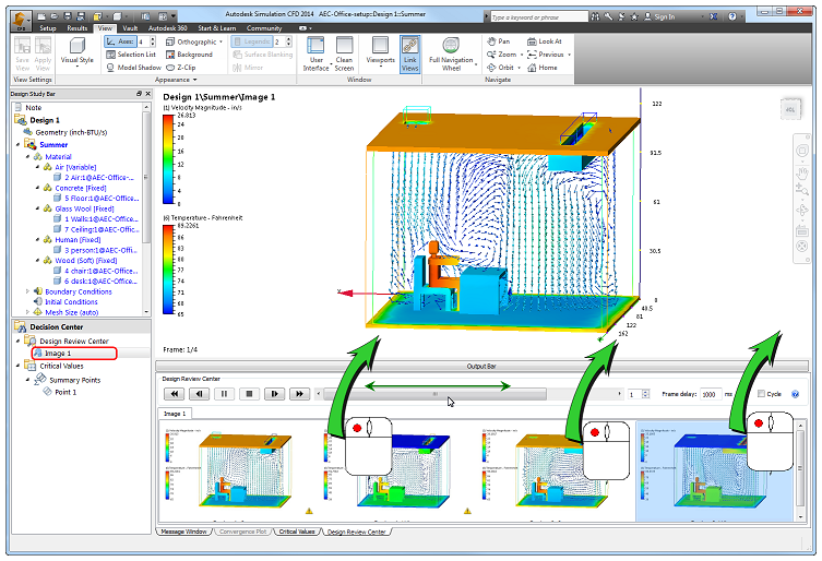

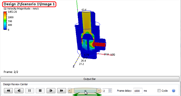

Use the Design Review Center to compare visual data with captured Summary Images. Click the image name in the Decision Center, and the image for each scenario appears in a separate thumbnail image in the Output bar. To add a thumbnail view to the display, drag it into the graphics window.
To view multiple images, drag the slider or use the "VCR" controls to flip between each design or scenario:
