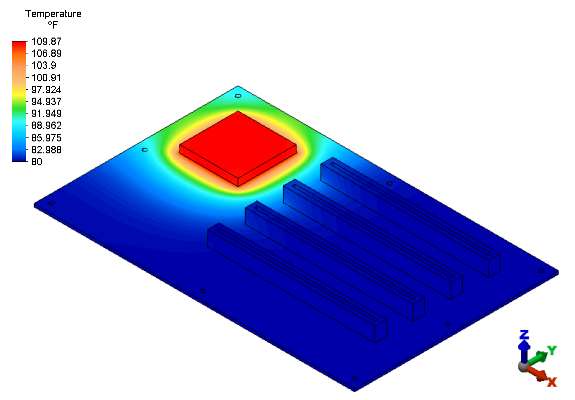

Analyze the Model
Click
Analysis
Analysis
Run Simulation
. After solid meshing, the analysis proceeds and the model displays in the Results environment.
Click
Results Options
View
Loads and Constraints
to hide the thermal load symbols if they are visible. The model should appear as shown below.
