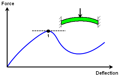

Any static analysis (Riks is a subset of static) must be statically stable to calculate a solution. In a nonlinear analysis, a model that starts out being statically stable can become unstable due to large deflections or material nonlinearities. Snap-through behavior and buckling are two examples of models that may become statically unstable. Riks Analysis is a special method to capture the behavior after the instability. In Figure 1, Riks analysis will continue to calculate the results (follow the force-deflection curve) after point 1. Other static analysis types may fail to find the curve after point 1. (An analysis with the complete Mechanical Event Simulation package can succeed because of the stability due to inertia.)
Figure 1: A Snap Through Becomes Statically Unstable Where the Tangent to the Force-Deflection Curve is Horizontal (point 1).

In a Riks analysis, the Total number of steps field on the Event tab of the Analysis Parameters are used to define the length of the analysis. (Since the analysis is static, time really has no significance. The number of time steps is really what is being set.) As time proceeds uniformly, the displacements are incremented at a uniform rate, and the force required to cause the displacement are calculated. The calculated forces are usually nonlinear with displacement (or time), such as in Figure 1.
